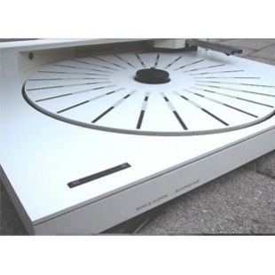

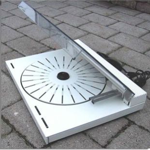

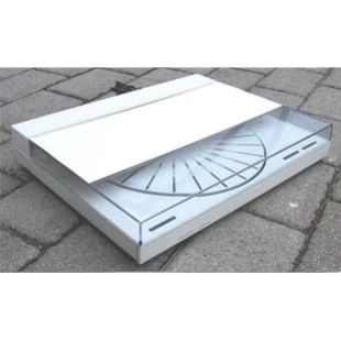

The next incarnation of the 5500 but now in a range topping system and hence supplied with the MMC2. The rest of the deck was unchanged except for the provision of a RIAA which now lived in the Beogram rather than the Beomaster. This allowed the fitting of a longer DIN lead and more flexibility in the positioning of the Beogram. Many thanks to Martin Olsen for the Images of his White 6500!
