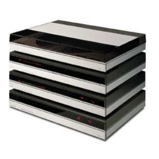

Beosystem 6500 - A masterpiece in four movements
The word masterpiece, when applied to Beosystem 6500, described both the sounds that emanated from its four functions receiver, CD player, cassette recorder and turntable and the look of its supremely elegant cabinet.
The eye immediately registered the power and self-confidence inherent in its clean unambiguous design. The distinguished sound quality provoked absolute enjoyment, without distraction. And the simple easy operation and programming provided amazing options for interchange and interplay.
Advanced two-way communication
The Master Control Panel allowed you to fully utilise the enormous potential of the Beosystem 6500. The components were made for each other. They spoke the same language and sought the same goal: perfection. And at any time you could access the Master Control Panel display and see which function you activated: radio, turntable, CD player or cassette recorder. You could see what level you set the volume. Which radio programme you selected or which track on your cassette or CD you were listening to.
Beomaster 6500
The Beomaster 6500 receiver was the brains behind the sound system. It communicated your wishes to the other sound sources; and ensured that they were carried out. You could receive AM and FM programming. And you could preset 20 stations which Beomaster 6500 automatically found and fine tune whenever you instructed it to.
Beocord 6500
A light touch to the front of the Beocord 6500 cassette recorder released the loader which glided out slowly and silently in order to allow you to insert a cassette. You could use whichever type of cassette you prefer; or choose between Dolby B or C Noise Reduction systems. And rejoice in Bang & Olufsen's patented HX-PRO recording system which ensured optimal sound reproduction, particularly in the difficult, high-frequency range. And, naturally, Beocord 6500 had auto-reverse so that both sides of the tape played as one.
Beogram CD 6500
If you wanted to indulge yourself with the finest sound quality then you'd do no better than listening to your favourite pieces of music on Bang & Olufsen's Beogram CD 6500. It played both 12cm and 8cm compact discs, and housed sophisticated and advanced digital technology. And it offered sound reproduction which would satisfy even the most demanding of listeners.
Beogram 6500
If you built up an LP Collection of good music to conjure up wonderful memories, you obviously would have wanted to enjoy it for many years to come. Which is why Bang & Olufsen put so much effort into Beogram 6500. The electronically-controlled tangential arm played the record exactly as it was recorded. Built in safety systems helped prevent vibrations reaching the cartridge or turntable. And Beogram 6500 automatically registered the size of the record you were playing and adjusted the speed accordingly.
The extremely light MMC2 cartridge provided superior sound reproduction while protecting your records as fully as possible.
