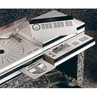

A light touch to the front of the Beocord 6500 cassette recorder released the loader which glided out slowly and silently in order to allow you to insert a cassette. You could use whichever type of cassette you prefer; or choose between Dolby B or C Noise Reduction systems... and rejoice in Bang & Olufsen's patented HX-PRO recording system which ensured optimal sound reproduction, particularly in the difficult, high-frequency range. And, naturally, Beocord 6500 had auto-reverse so that both sides of the tape played as one.
Beocord 6500 could be used as part of the Beosystem 6500 hi-fi system.
