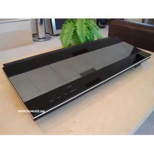

The mirrored exterior of aluminium and smoked glass gave no hint of the power hidden beneath the surface of Beosystem 9500. Central to the concept was the AM/FM receiver. On the flanks, CD player and cassette recorder awaited their turn in the spotlight. When they were needed, a light touch on the display panel was all that was required to make lids glide to the side giving immediate access to disc or cassette. The Beocenter was designed by Jacob Jensen and was the direct descendant of Beocenter 9000. The two models features here were superceded in 1994 by Beocenter 9300.
Simple logical operation
A light touch directly on Beocenter 9500 was all you needed to access its operation. The illuminated display led you logically through the programming and other functions always showing you what to do next. This ease and simplicity of use was the first impression you obtained of the music system. And equally easy to use was the optional remote control Beolink 1000 terminal.
Entertainment and information from three reliable sources
You could preset up to 20 FM and AM stations on the Beocenter 9500 receiver. And when you made your choice, search and fine tuning were completely automatic. Also, you could preset the receiver to switch on automatically to catch the news, or perhaps a favourite serial at just the right time. If you were out, the cassette recorder could be programmed to record and you could play back at your leisure.
You could also use the Beocenter 9500 receiver as a guaranteed alarm. In the event of a power failure during the night, the clock instantly switched to its own built-in batteries to ensure that you awoke at just the right time.
The CD player which accommodated both 12cm and 8cm compact discs was also ready for your commands. It gave you instant access to a specific track anywhere on the disc and allowed you to change the order in which the tracks were played, or to simply choose only those tracks you wished to listen to. Technology at its most convenient best. When used with Beogram 9500 the music system was known as Beosystem 9500.
The fine art of control of Beocenter 8500 & 9500
The unfailing sensi-touch control of the Beocenter 9500 works through a condenser effect. A graphite area is printed on the underside of the glass panel, and charged with a high frequency current. Even the lightest touch of a finger will spark the reaction.
