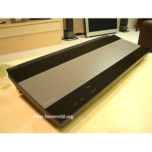

Beocenter 8500
For individuals who could live without time-programming but wanted the advanced features of the Beocenter 9500, Bang & Olufsen created the Beocenter 8500. There was no difference in the quality of the sound, but the cabinet was finished in a soft grey as an alternative to the polished aluminium finish of Beocenter 9500.
With both Beocenter 8500 and 9500, a dedicated record player - Beogram 9500 - was available.
