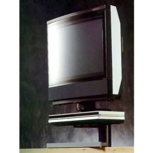

Beovision MX 5500 was perhaps Bang & Olufsen's most elegant high-format TV according to the 1990 catalogue. The screen was exactly the same size as other 66cm television screens, but the stereo loudspeakers were located underneath, creating a completely different look. Also, the flat design and polished surfaces in clear colours helped make this big TV seem light and elegant.
From your armchair, the whole TV could be rotated 35 degrees to either side with lust a press of the Beolink 1000 terminal. And, when you had Beocord VX 5000 video tape recorder working in conjunction with it, the MX 5500 opened up a world of technological sophistication that literally, needed to be seen to be believed.
Whatever stereo system you used, Beovision MX 5500 had stereo decoders that allowed it to do full justice to the most exquisite music track. It shifted from system to system automatically; you didn't even need to think about it. You could also use Beocord VX 5000 video recorder to record and playback 4 hours of stereo sound and picture or up to 8 hours of stereo sound alone.
Beovision MX 5500 contained the sum total of Bang & Olufsen's expertise in sound and picture technology. As well as giving razor-sharp pictures and totally natural colours, room was left for a satellite receiver module. And naturally, there were connections options for extra loudspeakers, computers, decoders, headphones, amplifier loop, TV games and a whole host more.
The slim, beautiful Beocord VX 5000 video recorder was carefully designed to match the Beovision MX 5500 TV.
