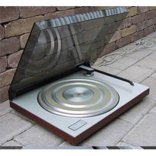

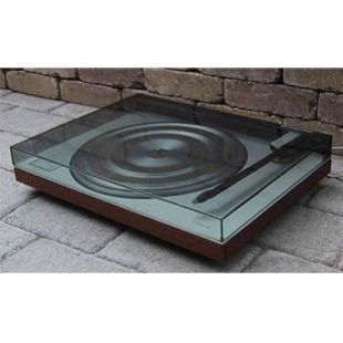

BeoGram 1900 Record Deck
Manufactured: 1976 - 1977
Designer: Jacob Jensen
The top of the range of the radial turntables at this time, it was differentiated only by a different pick up and a weighted platter from the lesser models. As with all this range, fully automatic and cleverly designed to look even lower than it actually was!
