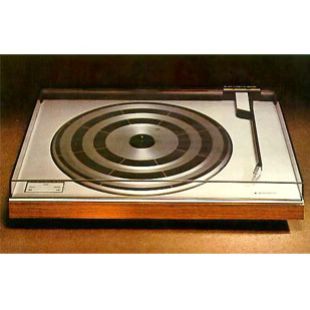

The most basic of a new range of beograms, this model was amongst the first to use the new MMC range of cartridges.
In the case it used the bottom of the range MMC3000 and was designed to be partnered by systems such as the Beomaster 1100.
Much more slim and elegant than the 2000 that it replaced, it featured the triple leaf spring suspension that was a feature of all Beograms from that point onwards. As one of the earlier models in this range, the 1100 used a belt and idler wheel drive mechanism. This would be replaced in the later 02 models with a simple belt drive.
These decks are beautifully made and offer super sound quality for almost no money. Much easier to maintain than the tangential decks simply because they are very simple! Excellent isolation from external vibrations - strongly recommended - and they were when new by Hi-Fi Choice!

BeoGram 1100 Record Deck Product Specifications
Type: 5705 (1976 - July 1977)
Sound system Stereo, matrix
Output DIN 2 x 0.6 mV
Speeds 33 - 45 rpm
Tonearm: radial
Stylus pressure range 0 - 2.5 g
Pickup MMC 3000, Stylus spherical diamond
Radius of curvature 15 µm
Recommended stylus pressure 1.2 g
Automatic pickup movement Yes
Automatic speed selection Yes
Wow and flutter, DIN: < +/- 0.1 %
Rumble DIN unweighted > 40 dB
Rumble DIN weighted > 60 dB
Speed deviation < 0.1 %
Speed control range > 3 %
Dial for speed Stroboscope 120mm
Tracking error
0.126° / cm
Lift system Mechanical
Antiskating: inclined channelling inside bearing
