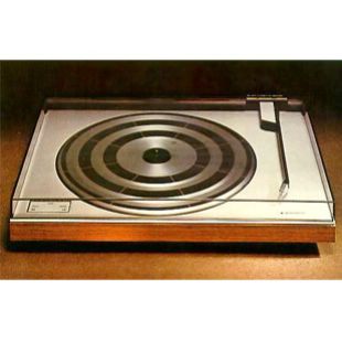

BeoGram 1102 Record Deck
Manufactured: 1974 - 1979
Designer: Jacob Jensen
Colours: Rosewood, Teak,White
Beogram 1102 was a fully automatic, hi-fi stereo record player with electronic servo-drive and high specification level. Operation was easy and straightforward. All functions were controlled by pressing the rectangular operating panel and if dissatisfied with the pitch of the record, speed could be adjusted by depressing the panel and rotating the little thumbwheel.
The pickup was an MMC 3000 with a spherical diamond. It tracked records at a stylus pressure of 1,2 grams. In order to fully exploit the pickup's outstanding qualities, B&O constructed an extremely light magnesium pickup arm which, together with its unique suspension, ensured low inertia and thereby good conditions for correct contact between stylus and both walls of the record groove - at all times. Even warped records could be played satisfactorily.
Despite high specification levels, Beogram 1102 and 1902 automatic record-players are extremely easy to operate. All the technicalities are hidden under the surface.
Bang & Olufsen's Electronic Servo Drive ensures that the rotatory speed of the Beogram 1102 and 1902 was always correct despite variations in the mains current supply. This is so because the system has a special feedback circuit which effects automatic corrections to compensate for these inherent variations
Beogram 1102 could be made up as part of the Beosystem 1100, together with other compatible Bang & Olufsen products
Beogram 1102 UK price in 1978: £97.00
These decks are beautifully made and offer super sound quality for almost no money. Much easier to maintain than the tangential decks simply because they are very simple! Excellent isolation from external vibrations - strongly recommended - and they were when new by Hi-Fi Choice! Simpler than the earlier 1100 - and better for that! A DC motor replaced the AC motor fitted to the 1100 and was electronically regulated with speed adjustment done through a potentiometer as opposed to the complicated measures used in earlier decks. This method would roll out across the range of Beograms.
