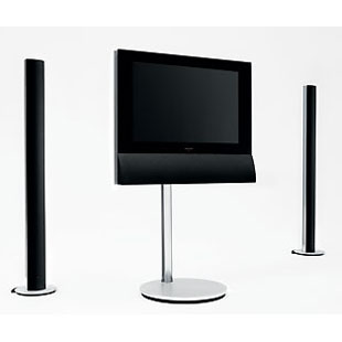

BeoVision 6 - 22 is an LCD 16:9 TV set introduced on 10 November 2003. It is fitted with a 51cm (diagonal) LCD screen which is coated similar to the Avant. Active speakers are positioned at the base of the monitor, similar to the MX range of television sets. The rear of the unit is curved, similar to that of BeoSound 1.
The unit is available in one colour only - Black - and is primarily designed for link-rooms: i.e. as an extra set for the kitchen or bedroom.
BeoVision 6 - 22 may be fitted with a motorised base which turns the set and also regulates the inclination. Standing possibilities include a low floor stand similar to BeoVision 5, wall bracket or a high floor stand high (as with BeoVision 1).

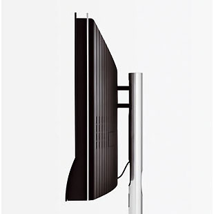

The solution was to equip the BeoVision 6 with a range of stands and wall fittings that make it easy both to turn the television from side to side and to tilt it up and down. The tilt function was a challenge to Bang & Olufsen’s developers. The first prototypes were either too clumsy and complicated or they were too difficult to operate. When the answer occurred one day to one of Bang & Olufsen’s engineers, it was so simple that it was difficult to understand why nobody had thought of it before.
A design that allows the television to revolve around its own centre of gravity is both simple and discreet – and at the same time it makes it possible to tilt a television weighing 18 kilos at the push of a finger. The rear of the BeoVision 6 is curved. Visually, this makes it appear even flatter than it is in reality, and at the same time its curved shape makes it possible to turn the television through greater angles, both on and off the wall.
