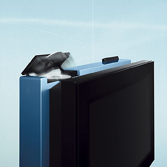

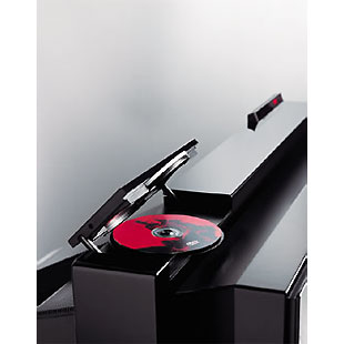

Watching movies should be about simple entertainment, not complicated technology. That's why the Avant is available with its own built-in DVD or video recorder. Its presence is only given away by a discreet lid on the front. All cables are hidden in the back of the set.
