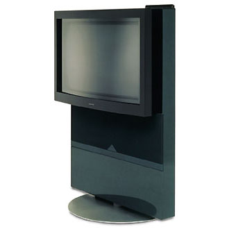

BeoVision Avant 28 VCR Product Specifications
BeoVision Avant 100 Hz 28 (VCR) Specifications
Dimensions W x H x D / Weight:
73 x 103 x 58 cm / 68 kg
Cabinet finish:
Black, silver, red, green, blue
Remote control included: Beo4
Stand turning function: +/- 35 degrees, remote operated, two memory positions
Power consumption: Typical 105 watts/standby < 3 watts
Picture tube (Visual picture):
16:9, 66cm/70cm (26"/67cm)
Wide-screen, real flat, In line 106 degrees
Curtain: Electronic
Contrast screen: Anti-reflection coated contrast screeen
VisionClear:
Auto picture adjustment, Auto cut-off, Digital CTI,
Adaptive Luminance Peaking, Scan Velocity Modulation
Improved letterbox, Motion Clear
Teletext:
Improved Teletext, Wide-screen Signalling (WSS), Fastext
(FLOF), 7 languages, 4 memory pages per programme
CTV system according to type:
B/G/D/I/K/L/L/M, PAL/SECAM, NTSC AV*
Tuner range: 45 - 855 Mhz, VHF band I-III, S, Hyper, UHF
TV programmes: 99
Stereo decoders:
According to type: A2 + NICAM B/G/L optional
A2 + NICAM B/G/I optional
NICAM I as optional
Video tape functions:
Video playing time, E-240: SP 4 hours, LP 8 hours
Audio playing time, E-240: LP 8 hours
Counter: Track, time left, time used
Index search: Track No.
Fast forward / rewind: 105 sec. w. E-180 (typical)
Slow motion: 1/2 and 1/12 x normal speed
Still picture: Noiseless
Cue: 5 x and 11 x normal speed
Recording system: HQ
Sound system: Hi-Fi stereo, video/audio
Playback:
According to type:
PAL, NTSC AV (Mono)/S-VHS in VHS quality
PAL/SECAM/NTSC AV (Mono)/S-VHS in VHS quality
Timer record programming: 8, 1 year
Synchronous Progr. Recording: PDC/VPS
Speakers:
Power amplifier modules: 4 units
Long-term maximum output power per module: 39 watts
Frequency range: 50 - 20,000 Hz
Sound pressure level: 96 dB
Cabinet principle / Net volume: Bass Reflex / 3.5 litres
Woofer: 115 mm - 41/2"
Tweeter: 18 mm - 3/4"
Bass equalizer: Adaptive
Magnetic leakage: Shielded
Connections for external source:
Video: Tape / decoder:
2 x 21 pin for AV and decoder .
AV for S-VHS in/out
Camcorder / Auxiliary: 3 x phono sockets (video in/audio L-R in)
S-VHS: Y-C playback 4-pin socket
Headphones: Mini jack
Beolink®: 1 x ML socket
Beolink® video distribution: RF out
Optional extra:
Sound processing module:
Part No. 4140
Dolby® Digital decoder
Sound modes (sound 1-5):
Stereo (Internal speakers), Stereo (External speakers)
Dolby-3 stereo, Stereo-4, Dolby® Surround
Connections (Part No. 4140):
External BeoLab speakers: 4 x Power Link
Speakers recommended front: BeoLab 1 / BeoLab Penta / BeoLab 8000
Speakers recommended rear: BeoLab 6000 / BeoLab 4000
Satellite module: Part No. 4158
Tuner range: 950 - 2,150 MHz
Programmes: 119 TV/Radio
Sound systems: Mono/Stereo
Satellite radio: Yes
Down conv. Supply: 14/18 volts control, Tone control (22 kHz) and DiSEqC
Connections (Part No. 4142):
Input: Aerial, 2 x 75 ohms
Optional extra:
Ext. positioner: Type No. 4170
Ext. power positioner: Type No. 4172
Picture in Picture module: Type No. 4165
NICAM decoder: Type No. 4144
Satellite: Type No. 4158
Dolby® Surround Pro Logic: Type No. 4140
Set-top Box Controller: Type No. 4167
System modulator:
Anti-reflection coated contrast screen
AV2 Expander box
* Type No. 8103/8403: I, PAL, NTSC, AV, NICAM, PAL/NTSC AV (Mono)/S-VHS
Type No. 8100/8400: B/G, PAL, NTSC AV, A2 - NICAM B/G, as optional, PAL/NTSC AV (Mono)/S-VHS
