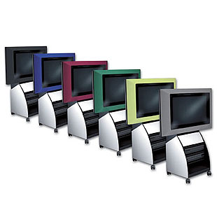

Colours: Black/Silver/Green/Yellow/Blue/Red/Green

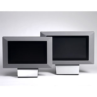

BeoVision 3 28 is a smaller version of the 77cm-screen BeoVision 3 32. The TV set incorporates similar functions to that of its bigger brother but is just a 67cm viewable screen and is designed to allow for greater flexibility in respect of positioning.
This smaller-screened television is, design-wise, the same as BeoVision 3 32. The chassis (50Hz) is basically the same as in BeoVision 1 Update III (50Hz); operation and specification is therefore the same (including the tuner and speakers).

Picture it for yourself: a wide screen elegantly framed in a colour of your choice. BeoVision 3 is designed to match your personal environment as well as your demands for a perfect viewing experience.

Cabinet finish
Black, Blue, Yellow, Grey, Red, Green.
