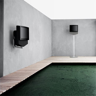

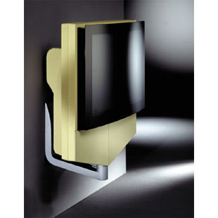

When it comes to placement options, BeoVision 1 spoils you with choice. Easy access, anywhere you want it, BeoVision 1 offers a range of five placement options, from table top to high and low floor stands, from wall mounting to a traditional stand with room for a VCR player. If you opt for wall mounting or the high stand, the power and aerial cables can be hidden inside the stand for seamless connection. Place it on a table with or without room for a VCR/DVD player. Or set it upon the special high stand and lift your television 2 metres off the ground.

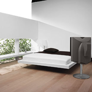

BeoVision 1 and Beocenter 1 are designed to be seen from all sides. Designed to stand like sculpture in the centre of a room. The ideas team therefore wished them to be mounted as high as possible in the room, or even out in the open under the open sky, if possible.
Just looking at BeoVision 1 or Beocenter 1 on its tall stand may not reveal the inspiration behind the solution but it is obvious when you hear it.

BeoVision 1 LS's flexibility stems primarily from a choice of five unique placement possibilities: from floating almost magically out from the wall, to sitting on a more traditional floor stand, to standing tall on a 160 cm column. Utilising the optional built-in motor, the BeoVision 1 LS can also be turned to face in different directions.

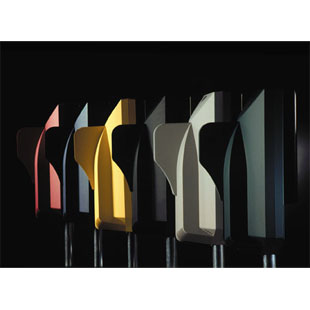

Externally, BeoVision 1 LS offers a truly colourful experience. It is available in six different colours: green, black, yellow, blue, red and grey. And all with matching fabric in the V-shape below the TV screen. This finishing touch helps ensure that the BeoVision 1 LS blends into any home interior.

Stands: Type: Height, incl. TV
Table stand 4185 82 cm
Floor stand, low 4186 105 cm
Wall bracket 4188 80 cm
Video stand 4189, High Gloss Black 119 cm
Floor stand, high 4187 (plate)
4194 (base)
4199 (tube) 231cm

Cabinet finish: black, blue, yellow, grey, red, green.
