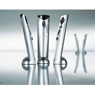

Beo1 remote control: 'Aesthetically yours'
" Absence can be the most expressive form of presence. Especially when it comes to designing a truly user-friendly remote control. Beo1 works together with Beocenter 1 and Beovision 1 to give you maximum freedom from a minimal number of buttons. The succinct Beo1 works in all directions and will lead you directly to a personalised on-screen menu holding all your favourite programmes. The perfect balance enhances usability, and polished aluminium completes the experience " (B&O catalogue 2001 - 2002)

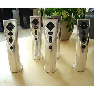

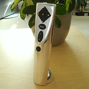

Beo1 is especially for the Beovision 1 and Beocenter 1 televisions. It is made from one piece of aluminium and is a natural aluminium colour. The main functions of both these TV receivers can be controlled using the unit; a display button can be stepped through in order to control the radio, DVD or TV in Beocenter 1. The Setup options for both TVs may be controlled using this remote control, too... the smaller brother of Beo4.
" Standard remote controls are unsightly plastic objects with too many buttons. Bang & Olufsen took the hard and the outstanding new way of shaping a modern material. Aluminium plates and profiles give new experiences to the consumer and high challenges for the designers and engineers. The functionality in combination with light weight, elegant design, durability and recyclability is of a very high standard. The machining of the basis, a hemispherical formed plate, was done on a lathe and attached to the rotating fixture by a film of frozen water.
Using the modern hydroforming technique for the organic cabinet part and sophisticated surface treatments as anodizing and grinding, gives the Beo 1 the modern but almost timeless look. Fitting the parts together, modern structural bonding techniques where used. The human experience is the centre of all efforts to ensure the fit between design and technology. The goal to realize a very friendly and a easy to use remote control in combination with a functional and elegant design was reached. "
Beo1 (with only 11 buttons) and banana-shaped cordless telephone - BeoCom 2 - are made of 100-percent polished aluminium. "We polish the round shapes with a 5-axis robot arm," says B&O spokesman Mr. Mortensen. "We want the naked aluminium because that makes the visual difference. Bare aluminium is very touch-sensitive: if a part has a fingerprint on the surface it cannot be anodized and cannot be used (in that case, it's recycled). And to achieve the colours we want, our designers had to acquire special anodizing knowledge."
