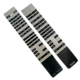

The Beolink 1000 family of remote controls is made up of four unique products; all similar in appearance, but each was brought out at a different time, for a variety of differing functions. First there was the Audio Terminal (or 'Terminal A'). This was then followed by both the 'Terminal V' (used by Beovisions LX2800 and LX2500) and then the 'Terminal AV'. Lastly was the Beolink 1000 as we recognise it today. Both of these latter Terminals are shown above.
The Audio and Video Terminals are similar in appearance to each other. However, they both accommodate different sets of buttons. With both these controls the bottom plate is stamped to differentiate them as either an Audio or Video Terminal. Size-wise, both Terminals are around 1,5cm shorter than a (current) Beolink 1000 Terminal.
Beolink 1000 Mk III was the last model produced and does not include a 'turn' button. To turn over the tape of your Beocord cassette deck, press SHIFT + SOUND.
In order to access 'Balance' press SOUND twice and then use the volume up and down to adjust.
To alter 'Treble', press SOUND three times and adjust in the same manner; for 'Bass' press SOUND four times.
To save your new settings, press SOUND and then STORE.
In comparison, the Terminal AV is about 1cm longer than a Beolink 1000. The Terminal AV could operate both audio and video and again was released before Beolink 1000. All three Terminals were black and dark grey coloured.
