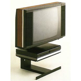

Beovision LX2800, LX2500
Beovision LX2800 and Beocord VHS 91.2 made up the ultimate video system. A harmonious fusion of aesthetic beauty, technical excellence and operational simplicity.
The combination of a 66cm flat-square TV and a stereo video recorder with up to four hours' video and eight hours' hi-fi quality music on a single tape hands you remote-controlled access to all forms of TV.
With its 63cm screen, Beovision LX2500 was the smallest member of the LX family in 1987. But no sacrifices were made in sound and picture excellence, nor was Beovision LX2500 ever caught out by new technical developments. No Master Control Link or additional speakers were required when installing a Beovision LX say, in the bedroom. The set came fully-equipped with a Master Control Link and all sound from the central music system could be fed through the TV speakers.
Installing a Beovision LX2500 in a study placed communication and information at your fingertips. Using a Beolink 1000 remote-control Terminal you could remote control and utilise all the features of the central system, including Teletext TV and video. And adding a home computer, video games and printer to the Beovision LX2500 used advanced electronics in a thoroughly practical way.
Beovisions LX2800 and LX2500 were identical in every detail except for the size of the picture screen.
Two television sets that were available but without Teletext, hi-fi sound or extra connection facilities were the Beovision L2800 and L2500. Other than these extra features, L2800 and L2500 were identical to the LX2800 and LX2500.
Designed by David Lewis, the televisions were released in 1986. At the time, the LX range was special as it was the first type of television to include a contrast-screen and automatic picture control called VisionClear. It was controlled by a 'V Terminal', the forerunner of Beolink 1000. It was also the first TV range with an Audio/Aux Link and hi-fi speakers.
