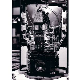

Like every other Bang & Olufsen product, Beovision AV5 was designed and crafted with the greatest care. To ensure that the powerful centre bass unit didn't interfere with the steadiness of the picture, it was mounted on an intricate suspension system, which in turn was anchored to a special aluminium chassis. The CD unit was perhaps the most robust then, on the market, to allow it to cope with the demanding environment - electronic noise, hot air and interference - in which it had to perform. And on top of all that, the entire unit was 'torture tested' hundreds of thousands of times to make sure that it could cope with the rigours of daily use!
Beovision AV5 construction
The rear of the AV5 is removed by undoing four screws. It may have taken some 150 tools and six construction engineers to make the parts and components, but as far as possible, one size of screw was used to assemble the AV5. The result was, up to 1999, the most advanced piece of electronic design ever to leave the Struer assembly line. Yet everything follows a strictly modular pattern, making maintenance and servicing logical and straightforward.

The antlers
The fact the loudspeakers disappeared into the front wall, calls for a special bearing structure. In the AV5, the heaviest component was the picture tube, which was fixed to a set of aluminium "antlers", a moulded aluminium space-frame which also carried the loudspeakers and most of the wiring. Cast in two pieces, it was custom-designed to hold wiring and fixtures that traditionally, would have been mounted with additional clamps and screws. Aluminium has the advantage of being light, but rigid and non-vibrating. It will not conduct sound or allow oscillations that could affect sound or picture reproduction.
'Dance steady' is a term that B&O takes dead seriously. It refers to a product’s ability to perform effortlessly, no matter how animated the surroundings. The company's secret remedy is rubber suspension. Inside the AV5, almost every vital unit was isolated from the bearing structure by little rubber sleeves. The transformer, the CD print card, the CD drive and last but not least, the centre bass, since it was the source of a sizeable proportion of the vibration pattern. Dance steadiness is measured on a vibrating table to determine the design of each individual rubber sleeve.
