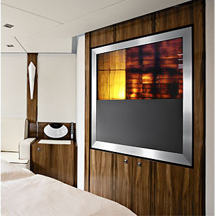

The screen
With its large screen, advanced sound system, original placement possibilities and multifaceted Bang & Olufsen virtues within operation, BeoVision 5 sets new standards for plasma solutions, not least regarding integration into the home environment
Until the advent of plasma technologies, the idea of hanging a television set on the wall has been confined to the realm of science fiction films. Now that the dream has become reality, Bang & Olufsen takes this possibility a step further by offering a plasma solution that encompasses much more than a simple 'picture on the wall'. BeoVision 5 is therefore a natural choice for people wishing to combine great viewing and listening sessions with flexibility in placement.
The frame
All Bang & Olufsen picture competencies are utilised to enhance the already razor sharp image of the large plasma screen. The 16:9 picture tops a pair of integrated active loudspeakers offering an enveloping stereo sound built with all the acoustic competencies for which Bang & Olufsen is known. As a result, BeoVision 5 does not require additional equipment to measure up sound- and picture-wise to demanding Bang & Olufsen standards. Furthermore, BeoVision 5 can serve as a Beolink® master, distributing sound and picture throughout the home in Bang & Olufsen's unique distribution system. Full compatibility with all Beolink®-enabled Bang & Olufsen products is included, as well as seamless connections with Bang & Olufsen's DVD 1 and Beocord V8000 VCR. Operation of all Bang & Olufsen items is carried out using the Beo4 remote control.

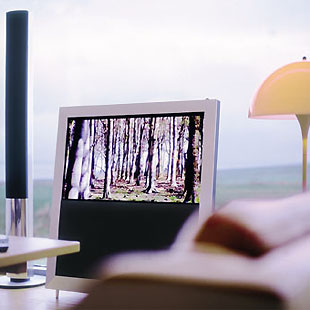

The placement
Offering a selection of brackets and stands, Bang & Olufsen offers a multitude of placement possibilities for BeoVision 5.
The sound
Featuring a pair of active loudspeakers located directly below the plasma screen, BeoVision 5 can provide up to 96 dB of stereo sound on its own. A built-in Dolby Digital® surround sound decoder offers a wealth of sonic experiences - and even includes automatic detection of this 5.1 channel digital sound format.
Connect any active loudspeakers from Bang & Olufsen's BeoLab range, and be moved by the deep bass and tingling highs found in today's digital entertainment offerings. Let your home cinema experience be led by the BeoLab 2 subwoofer, a double balanced passive radiator system where an 850 W ICEpower® amplifier (Long Term Maximum Output Power), supplies the fuel for the single active 22cm woofer and two 22cm passive radiators..

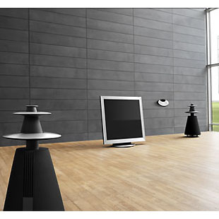

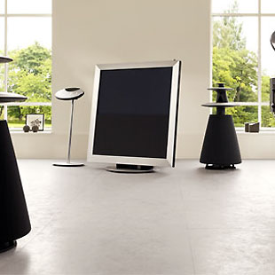

Positioning
Ideally BeoVision 5 should be set up with BeoLab 1's in aluminium in the front with BeoLab 2 and BeoLab 6000's in the rear. DVD 1 and Beocord V8000 should both be housed in the purpose built silver cabinet.
