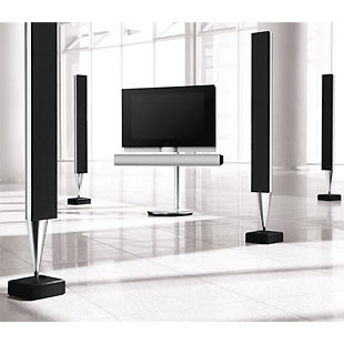

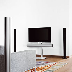

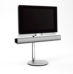

BeoVision 7 combines both an 81cm LCD monitor with an integrated DVD Player, DSS surround sound module and a dedicated loudspeaker in BeoLab 7-1. The concept emphasises the separation of picture and sound together with a good number of placement options. With BeoLab 7-1 the very highest level of acoustic performance is delivered. BeoVision 7 has a higher display resolution than that of BeoVision 6 - 26: 1366 x 768 (WXGA) pixels against 1280 x 768 pixels of BeoVision 6.
BeoVision 7 may be used as either a stand-alone television set or as a large-screen monitor within a domestic surround-sound system. There are five different stand placement options available to the user:
Mounting Options & Stands
Original Bang & Olufsen stands available at launch included: Fixed position Table Stand, motorised Table Stand, motorised Table Stand, moveable Wall Bracket for TV and Loudspeaker (close or extended versions) and a motorised Floor Stand. A fixed Wall Bracket for BeoVision 7 32 was added to the stand portfolio after launch.
Each of the above options hold both the monitor and the BeoLab 7-1 active speaker; with the exception of the Table Stand, each has the vertical tilt feature.
