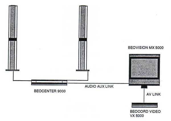

Audio Aux Link
Audio Aux Link is the connection between
a Bang & Olufsen MX 5000 television and a Bang & Olufsen Beolink compatible
audio system. This connection is also known as a Beolink connection.
Signals
Both analogue stereo sound signals and two way Datalink codes for operation and
display are transferred. Audio signals are in two directions. This gives the
ability to play audio signals from the video system through the audio system, as
well as allowing programs from the audio system to be played through the MX 5000
TV set.
The Audio Aux Link connection also permits sound from the VX5000 VCR to be
played through the audio system and sound from the audio system to be recorded
on the VX5000. This connection takes place automatically whenever a VX5000 is
connected to an MX 5000.
In practice, the Audio Aux Link connection is identical to the Audio Link
connection for BeoCord audio. Therefore, the same types of cables and extensions
which are used for two way Audio Link connections may be used for Audio Aux Link
connections.

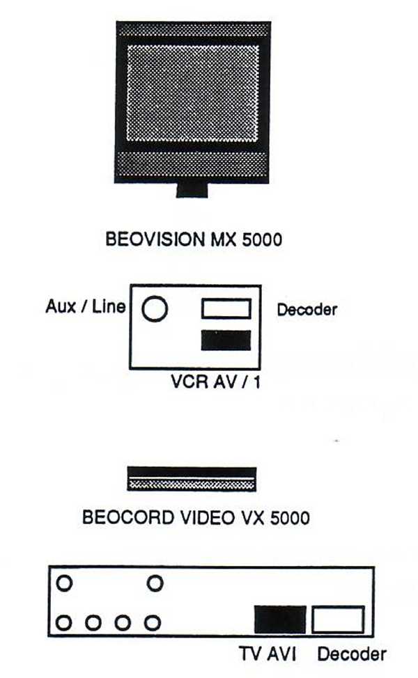

AV Link
AV link describes the connections between the MX5000 TV and the VX5000 VCR.
Signals
The AV link transfers audio, video and data signals between the MX5000 TV and VX5000
VCR. A special cable with 21 pin SCART plug on each end is used to accomplish
the AV link connection.
Audio signals are transferred in both directions between TV and VCR. This allows
sound recording from the audio system via the Aux Link connection to the TV set,
as well as playback of stereo sound from the VCR through the TV or the audio
system.
Composite video signals are transferred from the TV to the VCR. This allows
recording from a second VCR, camcorder or other video source.
