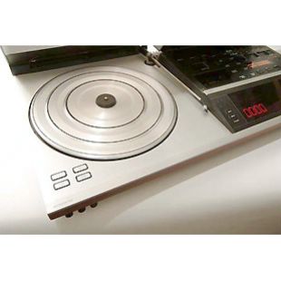

Beocenter 7007 (also known as Beosystem 7007)
Top quality sound and maximum listening comfort were the main features of this integrated hi-fi system. Records, radio, cassette tapes and a 2 x 40 watts RMS stereo amplifier could all be controlled from anywhere in the room using the slim remote handset. Without moving more than a finger you could select any sound source, adjust volume level, fast wind the tape and even make recordings. This supreme ease of operation was made possible by microcomputer technology. In addition, there were two user-programmable microcomputers which allowed you to make unattended recordings at any time within a 24-hour period, or to play any sound source automatically at a pre-selected time - day after day, if you wished.
A further advantage was easy access to cassette recordings: just key in the appropriate counter reading (address) and the cassette would fast wind to the required passage of music. Ferric, chrome or metal tapes could all be used and Dolby B Noise Reduction was included to ensure clean, hiss-free recordings.
The automatic record deck had an ultra-lightweight arm carrying the MMC 4 pickup cartridge. The radio section covered Long, Medium and FM bands with facilities for pre-setting 6 favourite stations.
The recommended speakers were the Beovox S55 . Speaker pedestals or the SC70/ SC77 hi-fi cabinet could be added optionally if required.
