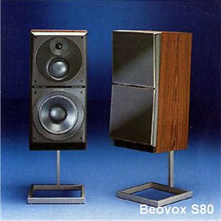

Beovox S80 Passive Loudspeakers
Manufactured: 1981 - 1986
Designer: Jacob Jensen
Colours: Rosewood, Teak, White, Oak
Beovox S80-2 speakers gave neutral sound reproduction with the added realism afforded by depth definition and perspective.
There was a 7,5cm mid-range/phase-link unit combined with a 20,5cm woofer and 2,5cm dome tweeter to provide a wide frequency response and no audible phase distortion. Overload protection was automatic. The cabinet was of pressure chamber construction. Optional pedestals and wall-fixing kits were available.
