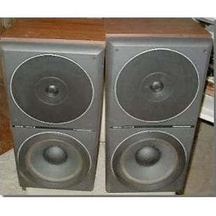

Beovox S50 Passive Loudspeakers
Manufactured: 1980 - 1982
Designer: Jacob Jensen
Colours: Rosewood, Teak
Uncommon in the UK, the smallest of the range at the time and a two way speaker. Replaced by the S45 which was also downgraded in comparison with a captive lead.
_________________________
