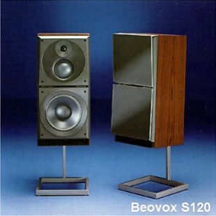

Beovox S120/MC120.2 Passive Loudspeakers
Manufactured: 1983 - 1988
Designer: Jacob Jensen
Colours: Rosewood, Teak, White, Oak
Overload
Beovox S120 is designed to handle 120 watts continuous load and can handle temporary loud passages throughout the entire audio range.
The speaker has a built-in protection circuit continuous overload. If the speaker output significantly exceeded 120 watts sinus, the speaker is cut out and the OVERLOAD indicator on the front lights up. The speaker is cut in again by pressing the button to the right of the indicator light. This protection circuit does not react to temporary signals and does not cause clipping or distortion.
Beovox MC 120.2 would handle up to 120 watts RMS power. The 20cm woofer, 7,5 mid/phase-link unit and 2,5cm dome tweeter were protected from overload by an automatic circuit. The port reflex cabinet allowed for full bass performance despite modest size. This model could be placed in a shelf system. Alternatively, optional wall-mounting brackets and floor pedestals were available.
Beovox S120/MC120.2 Passive Loudspeakers Product Specifications
Type: 6413
Description: RMS power handling capacity 120 watts
Music power handling capacity 170 watts
Impedance: 8 ohms
Frequency response 4+ -8 dB 42 - 22,000 Hz
Frequency response +/- 4 dB 70 - 20,000 Hz
Sensitivity 2.5 watts
Distortion 250 - 1000 Hz : <2.5%
Distortion > 1000 Hz: <0.5% Woofer: 20.5 cm, throw +/- 5 mm
Phase-link, mid-range: 7.5 cm dome
Tweeter: 2.5 cm dome
Net volume: 24 litre
Gross volume: 40 litre
Dimensions W x H x D: 26.5 x 56 x 27.5cm
Weight 12 kg
Beovox MC 120.2 Specifications
Type: 6433
Impedance: 8 ohms
Sensitivity 2.5 W
Distortion 250 - 1000 Hz <2.5%
Distortion > 1000 Hz <0.5% Woofer: 20.5 cm, throw +/- 5 mm
Weight 12 kg

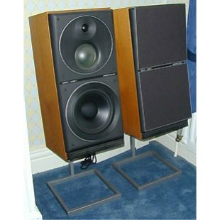

These were extremely fine speakers with a superb sound and flat frequency response. They do suffer from foam rot and are hence very cheap these days. A replacement Peerless woofer is available or recone the original. Described to the author by a B&O insider as one of the best passive speakers made by B&O.
