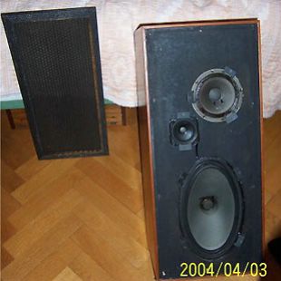

BeoVox 1500 Passive Loudspeakers Product Specifications
Beovox 1500 Specifications
Dimensions: 635 (width) x 280 (height) x 305mm (depth),
Volume 38 Liters.
Three-way with crossover frequencies at 800Hz and 5KHz.
Woofer : Seas 28/17 TV-GW
Midrange : Peerless G 50 MRC
Tweeter : Peerless MT 25 HFC
Frequency range 45-18000Hz (DIN 45570).
Power rating 15W (25W max).
Impedance 4 Ohms.
Available in Teak and Rosewood.
Has a midrange adjustment (rotating switch with 5 settings) at the back.
A 2 pin DIN socket is provided to attach an external tweeter such as the Beovox 2500.
