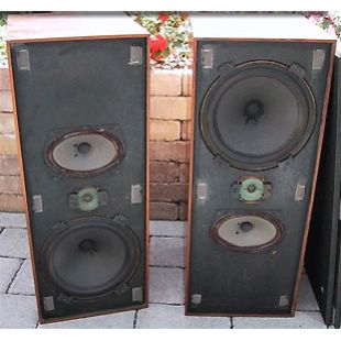

Owner Tip!
To replace the speaker cable:
Take out the bass driver from the front after removing the cloth cover. The crossover unit is behind and is held onto the back with (generally) four screws. Remove these and you should be able to pull the wire through and replace it.
