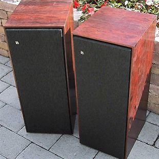

BeoVox 2600 Passive Loudspeakers
Manufactured: 1969 - 1972
Colours: Rosewood, Teak
Rated at 30W, the Beovox 2600 was powerful enough to be used with the Beomaster 3000, though it was also recomended for use with the Beomaster 1000, 1200 and 1600.

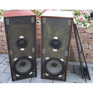

Slightly larger than the Beovox 1200 of the same year, it was fitted with an 8” woofer with a rubber roll edge and a 1.5” dome tweeter. Befitting a loudspeaker to be used with the excellent Beomaster 3000, the Beovox 2600 met all the conditions of the DIN 45 500 “hi-fi” standard.

Number of units
Bass unit: 1 x 20cm
Mid-range One DOME unit
Tweeter: 1 x 5cm
