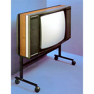

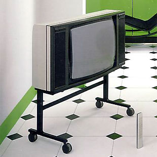

BeoVision 8902
Manufactured: 1984 - 1987
Colours: Wood Effect or White
Beovisions that put the future at your fingertips

BeoVision 8902 Product Specifications
Beovision 8902 Specifications
