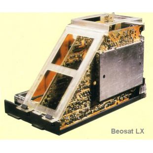

Beosat LX
Manufactured: 1990 - 1994
Colours:
Satellite broadcasts in the UK began in 1989 with the introduction of 'BSB'. To accommodate this potential, different manufacturers released satellite equipment for reception of TV and radio programmes from space.
The transmissions were analogue in the early days; digital transmissions gradually took over until analogue reception came to a halt in 2000. Bang & Olufsen recognised customer interest in this new area and brought out Beosat: satellite equipment which could be added to an existing TV setup. Both a dish and a receiver were needed - Beosat RX was deliberately shaped to look like a video recorder in that it would fully match existing equipment. Bang & Olufsen's parabolic antennae were available in two sizes - 60cm and 91cm - in order to provide options for people who live where they could receive either strong or weak signals. The bigger of the two was for areas were satellite reception was not very strong.
A Positioner module, type no. 3012, was available as an installation accessory . The Positioner module controlled the polar mount motor that turned the dish towards another satellite, and the satellite positions could be stored with the programme number. Turning was then carried out automatically every time you switched to a programme from another satellite position. The Positioner module also contained the necessary power supply for the actuator motor on the outdoor unit.
Beosat LM satellite receiver could be incorporated within all Beovision LX-L-MX models. It was sold as an extra module for incorporating within the cabinet of the then, latest sets. For those with slightly older sets, Beosat RX could be bought as a 'set-top- box' for inclusion within a TV system, as a standalone item. It was designed as an extremely compact installation kit, measuring approximately 65 x 165 x 155mm and functioned as an integral part of the TV with similar operation, status lines and on-screen menus.
Beosat LM could be incorporated within all Beovisions produced from 1989 until 2001 - with the exception of the MX 1500, ME and LE versions. After 2001 the user would have to ask his about his specific model. This was because software updates did not include Beosat LM as a first choice.
Beosat LM allowed you to receive 99 TV and radio programmes from 40 000km in space. The satellite it was specifically meant to cover was the ASTRA satellite, and was already pre-programmed into the unit. Beosat LM could be expanded at a later date with a Power Positioner module which allowed control of motorised dishes.
A D2MAC decoder was available as an option for the Beosat LM, which made it possible to receive programmes in the D2MAC format. One of the benefits of this particular format was that it facilitated pay-TV with the addition of a card reader. This was used for programmes encrypted to the EuroCrypt M standard like 'FilmNet' and the Scandinavian satellite channel 'SCANSAT TV3'.

Beosat LX Product Specifications
Type: 3022 (1987 - Dec 1992)
Operation Beolink 1000, Video or Audio/Video terminal
Satellite system ECS (European Communication Satellite
SES (ASTRA)
Prepared for DBS (Direct Broadcasting satellite
Tuning range 950 - 1750 MHz
Input level -25 dBm to -65 dBm
Number of programmes 32
Sound system
Mono and stereo
Sound tuning Fixed mono 6.6 MHz
Fixed stereo 7.02 MHz (left), 7.20 MHz (right)
Tuning range 5.5 - 8 MHz
Sound bandwidth Super wide 900 kHz
Wide 280 kHz
Narrow 130 kHz
Sound deemphasis 50/75 µs, J17 and 75EXP
Factory setup:
1. Setup Band - 11
Polarity - ROTOR
Input - AUT
Auxiliary - OFF
Text decoder - ON
2. Sound tuning Fixed mono (6.6)
Fixed stereo 7.02 / 7.20
Connections: P113 Outdoor Control:
Pin 1 LNB select 11/12 GHz
V out 5 V
R out 600 ohms
Duration 3. sec.
Pin 2 Ext. polar/Polar rotor/ODU data
Pulse width 0.8 - 2.2 msec.
T repetition 15 - 18 msec.
Pin 3 Ground
Pin 4 5V
I max 550 mA
Pin 5 ODU data
Threshold level type 1.5 V
R in 12 kohms
F clock 600 Hz
Pin 6 Sat. tuner AGC
V out 7-0.5 V
Aerial sockets Impedance 75 ohms
15V on conductor 1 for vertical polarization or on conductor 2 for horizontal polarization
I max 300 mA
