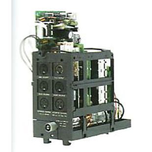

Beosat LM satellite receiver could be incorporated within all Beovision LX-L-MX models. It was sold as an extra module for incorporating within the cabinet of the then, latest sets. For those with slightly older sets, Beosat RX could be bought as a 'set-top- box' for inclusion within a TV system, as a standalone item. It was designed as an extremely compact installation kit, measuring approximately 65 x 165 x 155mm and functioned as an integral part of the TV with similar operation, status lines and on-screen menus.
Beosat LM could be incorporated within all Beovisions produced from 1989 until 2001 - with the exception of the MX 1500, ME and LE versions. After 2001 the user would have to ask his about his specific model. This was because software updates did not include Beosat LM as a first choice.
Beosat LM allowed you to receive 99 TV and radio programmes from 40 000km in space. The satellite it was specifically meant to cover was the ASTRA satellite, and was already pre-programmed into the unit. Beosat LM could be expanded at a later date with a Power Positioner module which allowed control of motorised dishes.
A D2MAC decoder was available as an option for the Beosat LM, which made it possible to receive programmes in the D2MAC format. One of the benefits of this particular format was that it facilitated pay-TV with the addition of a card reader. This was used for programmes encrypted to the EuroCrypt M standard like 'FilmNet' and the Scandinavian satellite channel 'SCANSAT TV3'.

Internal mounting with only the socket panel visible at rear of TV set

Beosat LM Product Specifications
Type: 3002 ( 1989)
Specifications: Function TV Satellite mounting kit
Designed for: L/LX 5500/4500, MX 5500/3500, LS 5000/6000, LX 5000/6000,
MX 4000/6000/7000, AV 9000, MX 4000/6000/7000Beo4
MX 4000/6000/7000IT, AV 9000Beo4, AV 9000IT, MS 6000
Remote operation Beolink 1000/Beo4
Display TV screen Operation status, program list
Menu operation Tuning, Setup
Satellite system Astra, DFS, ECS, Intelsat, Telecom
DBS: (wih MAC decoder)
Timer programming Beocord VX 4000/45000/5500, VX 5000/7000, V6000, V8000 recording
Beovision mute
Tuning system PLL
Video system:
Program numbers 99
Tuning range 950 - 2050 MHZ
Input level -30 dBm to -60 dBm
Deemphasis Pal/Mac
Video level Pal: 16,20 and 25 Mac: 13 and 20
MAC Prepared for ext. MAC Decoder
Sound system:
Mono and discrete stereo
Sound tuning, fixed mode Mono 6.6 MHz
Stereo 1: L7.02 Mhz, R 7.2 MHz
Stereo 2: L 7.38 MHz, R 7.56 MHz
Sound tuning range Mono-stereo 5.5 MHz - 8.5 MHz
R channel 180kHz higher than L
Sound bandwidth Mono 130 kHz, 280 KHz, 900 kHz, stereo 130 kHz
Sound deemphasis Mono 50µs, 75µs, J17, stereo 75 µs
Sound expand function Automatic at 130 kHz bandwidth
Connections: Satellite antenna 75 ohms, parabol dish ofr cable system, Power supply LNB
18 V 300 mA, 14/18V or tone switch on coax
Outdoor control, 6 pin
Pin1 LNB select Low/High
V out 12V / 100mA
R out 26 ohms
Pin3 Gnd
Pin5 Polarizer
Current range -50 mA +100 mA
Relay mode
12V/max. 100 mA
Pin6 Dish select
Actuator control, 5-pin (with positioner module)
Pin1 Grid
Pin2 Motor+
Pin3 Motor-
V out 30 V I out 1A
I max. 2A
Short circuit current 3.1 A
Pin4 Feedback DC
V in 0-5.0V
Input impedance 10kohms
Feedback tacho
H level > 2.5 V
L level < 1.0 V
Input impedance 10 kohms
Pin5 Supply 5V/30mA ref.
Decoder Video, 8-pin
Pin1 Composite cideo in (75 ohms)
Pin2 Gnd in
Pin3 Gnd out
Pin4 Composite video in 1 ( 75 ohms)
Pin5 Baseband out 2 (75 ohms)
Pin6 Baseband out 1 (75 ohms)
Pin7 Composite video out (75 ohms
Decoder Audio, 8 pin
Pin1 Audio L in > 50 kohms
Pin2 Gnd
Pin3 Audio L out < 1 kohms
Pin4 Audio R in > 50 kohms
Pin5 Audio R out < 1 kohm
Pin6 Acces to service mode when connected to ground
Pin7 Future use
Pin8 Not used
