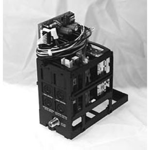

Satellite broadcasts in the UK began in 1989 with the introduction of 'BSB'. To accommodate this potential, different manufacturers released satellite equipment for reception of TV and radio programmes from space.
The transmissions were analogue in the early days; digital transmissions gradually took over until analogue reception came to a halt in 2000. Bang & Olufsen recognised customer interest in this new area and brought out Beosat: satellite equipment which could be added to an existing TV setup. Both a dish and a receiver were needed - Beosat RX was deliberately shaped to look like a video recorder in that it would fully match existing equipment. Bang & Olufsen's Parabolic Antennae were available in two sizes - 60cm and 91cm - in order to provide options for people who live where they could receive either strong or weak signals. The bigger of the two was for areas were satellite reception was not very strong.
A Positioner module, type no. 3012, was available as an installation accessory (see below right). The Positioner module controlled the polar mount motor that turned the dish towards another satellite, and the satellite positions could be stored with the programme number. Turning was then carried out automatically every time you switched to a programme from another satellite position. The Positioner module also contained the necessary power supply for the actuator motor on the outdoor unit.
A D2MAC decoder was available as an option for the Beosat LM, which made it possible to receive programmes in the D2MAC format. One of the benefits of this particular format was that it facilitated pay-TV with the addition of a card reader. This was used for programmes encrypted to the EuroCrypt M standard like 'FilmNet' and the Scandinavian satellite channel 'SCANSAT TV3'.

The fact that Beosat LM was an installation kit had a number of advantages including:
Interaction between the TV and the Beosat module which could be optimised both technically and operationally
The module shared the cabinet, power supply etc. with the Beovision, which meant, other things being equal, fewer components and better value for money
Building the satellite module into the TV gave an elegant video system, thus saving space without compromising technical performance.
