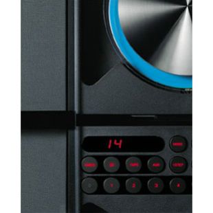

The fine art of control of BeoSound Century
The backlit push buttons of the BeoSound Century are cast in opalescent plastic, painted black on the inside and the text is then burnt away with a laser. The light of a diode behind each button is muted for even distribution, and the button is hinged in four places. A sturdy and relatively inexpensive construction, but it takes just a bit more work!
Operation of BeoSound Century
How do you make operation easy when there are 26 buttons to push? On BeoSound Century, only the buttons you need for the specific function will light up and guide you step by step through operations.
