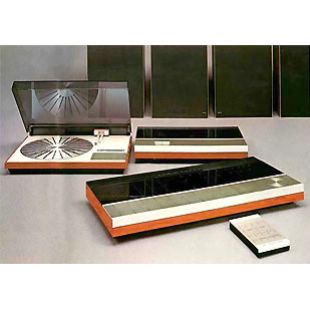

Pictured is the BeoSystem 6000 from 1974.
