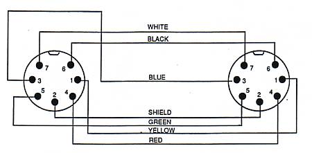

Aux Link cable, male to male, using unterminated cable number 6250265 and plug number 7220688 or 7220701. For connection between video system and audio system. Maximum length: 100m:
| white | data |
| blue | left channel input |
| green | right channel input |
| shield | ground |
| red | right channel output |
| yellow | left channel output |
| black | data ground |

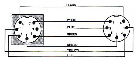

Aux Link/Datalink cable, male plug to wall plate, using unterminated cable number 6250265. Use male plug number 7220688 or 7220701 and an 8-pin wall plate number 7210473. Used for connecting local sources when MCL 2AV is concealed:
| white | data |
| shield | ground |

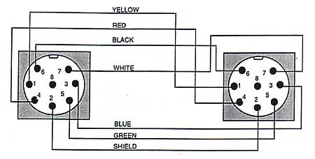

Aux Link cable, wall plate to wall plate, using unterminated cable number 6250265 and two 8-pin wall plates number 7210473. Used for connection between audio and video systems within the wall wiring:
| Audio System | Video System | |
| white | data | data |
| blue | left channel input | left channel output |
| green | right channel input | right channel output |
| shield | ground | ground |
| red | right channel output | right channel input |
| yellow | left channel output | left channel ground |
| black | data ground | data ground |

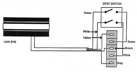

Switch for deactivation of MCL transceiver when temperature falls below freezing point (0 degrees Celsius). Double pole, single throw switch inserted between white wire, green wire and terminal strip in relay box:
