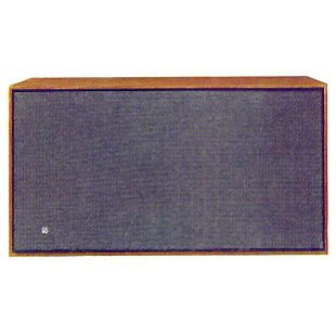

BeoVox 3000 Passive Loudspeakers
Manufactured: 1967 - 1971
Colours: Rosewood, Teak
Beovox 3000 was the ideal smaller loudspeaker for the Beolab system: it had a special bass unit, a separate mid-range and two high frequency units. There was provision for individual adjustment of mid-range and high-frequency levels, and a socket for a high-frequency diffuser (Beovox 2500).
Beovox 3000 type 6220 and 6238 was a pressure-chamber loudspeaker with a specially-designed bass unit, a separate mid-range speaker and two high-frequency speakers - a total of four units. There was a crossover network and provision for individual adjustment of mid-range and high-frequency levels. There was also provision for the connection of a high-frequency diffuser. The maximum power handling capacity was 50 Watts.
