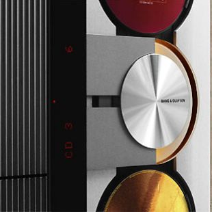

The discs are easily loaded and held by spring suspended jaws. Discs not in play can be replaced without interrupting the playback. The auto-positioning feature ensures that CDs are always returned to the position in which they were first placed. With the CDs visible and positioned correctly, there is easy access to the text information printed on the label. The glass-covered natural aluminium plate holds the CDs and the rails for the CD carriage, while a backlit acrylic plate illuminates the CD currently playing.
Glass cover to counteract gravity
BeoSound 9000 offers unprecedented flexibility for a product of this type, and to ensure the same uniform movement of the glass cover regardless of the placement of BeoSound 9000 vertically or horizontally, upright or flat. To counteract the effect of gravity, a digital time control constantly monitors the movement of the cover and adjusts the motor, keeping the complete movement within 3.5 and 4 seconds.
Safety first
Such an abundance of fast moving mechanics means that special measures have been taken to ensure that BeoSound 9000 is safe to operate. Small prismatic lenses are placed at each end of the aluminium frame, controlling an infrared beam across the front of BeoSound 9000. If the beam is violated, the CD clamper will stop immediately.
If the glass door is lifted while the clamper is in motion, it will decelerate immediately. A power failure feature ensures that the clamper is not damaged in a gravitational free-fall, if BeoSound 9000 is mounted vertically.
Ingenious engineering solutions and intricate mechanical movements in a product that continues to surprise and delight users today – and all this from the inspiration of old vinyl records spinning on the record player’s turntable.
The unit may be played in one of seven different positions. In each one, gravity has a different effect on the CD clamper (the aluminium 'arm' which rests over each CD when it is being read), yet it still works with the same precision and speed: a good example of how Bang & Olufsen uses technology to overcome acceptable limitations. Place BeoSound 9000 upright in a bookcase, lay it flat on a shelf or hang it directly on the wall - either vertically or horizontally. It can stand, for example, between a pair of BeoLab 1 or BeoLab 8000 loudspeakers (as above), or with any other speaker in the BeoLab range. With BeoSound 9000, the possibilities - and the enjoyment - are endless!

Auto-positioning was one of the challenges that Bang & Olufsen's engineers had to meet because of BeoSound 9000's clear versatility in placement. Using the inaudible initial lead information present on most compact discs, the BeoSound 9000 is able to detect and memorise a desired position for the CD.
When it's time to stop the CD, a servo system decreases the speed of rotation, the position mark is detected, and this effects the final braking and halt. A servo calculates the braking length for the CD, processes and stores the information. So the next time the CD will stop even faster, because BeoSound 9000 now knows where and when to apply the brakes. A total of 360 perforations ensure that your CD will stop precisely at the point at which you placed it in the rack.
The secret behind the precision of the movable clamper lies in two sensors which monitor its exact position and speed more than 60 times a second, and in its digitally-controlled motor, which compensates for even the slightest variation in movement.

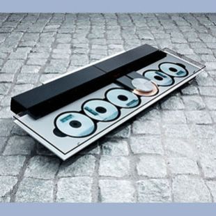

Placement
On the optional bracket, the BeoSound 9000 displays itself raised at an angle, or standing tall. Attach it horizontally and watch all the CDs stop in exactly the same positions as they were loaded in. Or you might opt for the floor stand as a bold musical statement. Hang BeoSound 9000 vertically on the wall and see how the display automatically changes orientation if you reverse the control panel.

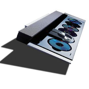

Six CDs presented neatly in a row, with all the titles legible. After playback, BeoSound 9000 simply stops its CDs in exactly the position in which they were first loaded.
Auto-positioning was one of the challenges that Bang & Olufsen’s engineers had to meet because of BeoSound 9000’s clear versatility in placement. Using the inaudible initial lead information present on most compact discs, the BeoSound 9000 is able to detect and memorise a desired position for the CD.
When it’s time to stop the CD, a servo system decreases the speed of rotation, the position mark is detected and this effects the final braking and halt. A servo calculates the braking length for the CD, processes and stores the information. So the next time the CD will stop even faster, because BeoSound 9000 now knows where and when to apply the brakes. 360 perforations ensure that your CD will stop within just 1° of the position in which you put it on!
BeoSound 9000's CD reader is propelled back and forth by a powerful motor. An optical system allows a microprocessor to monitor the reader's movement between the six CD stations. The total distance of 63 cm is divided into 1,040 separate positions so that the reader can be positioned to an accuracy of just 0.6mm. Given that the reader accelerates from 0 to 100km/h in just over five seconds, it's vital that the electronic and mechanical components are in perfect harmony. BeoSound 9000 is one of Bang & Olufsen's most compact products, housing no fewer than 2,910 different components.
