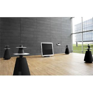

BeoLab 5
" If your ultimate passion is to get as close to the music of your favourite artists as possible, the new BeoLab 5 will take you there. Conceived, designed and built by Bang & Olufsen, BeoLab 5 is (their) latest loudspeaker concept developed for everyone with a passion for listening and living with the ultimate in audio and video entertainment."

Standing at just under one metre tall, BeoLab 5 represents Bang & Olufsen's latest 2500 Watt high-end loudspeaker and comprises two new innovative technologies which have taken a decade to perfect. The speaker is a result of the Eureka Archimedes Project, developed between Bang & Olufsen of Denmark, KEF Electronics Limited of the UK and The Acoustics Laboratory of the Technical University of Denmark.
