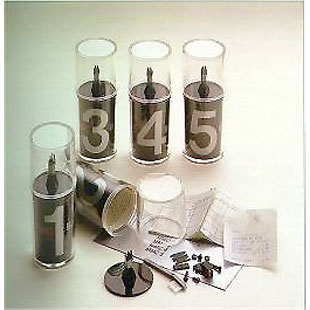

Unlike many other manufacturers, Bang & Olufsen insisted on developing pick-up cartridges for its own record-players. When the first stereo records were produced in the USA there were still no stereo cartridges in Europe. Bang & Olufsen took up the challenge and developed the first stereo cartridge based upon the Moving Micro Cross principle. Refined and improved upon, this principle withstood the test of time. Apart from fulfilling certain demands, e.g. a small effective tip mass, high channel separation, wide flat frequency response, low tracking force etc. after a few adaptations the MMC principle proved extremely useful in the reproduction of discrete four channel records (Quadradiscs) in the 1970s.
Through the MMC 1 to 5 range of cartridges, the diamond, cantilever and micro-cross formed a unified entity of super light-weight design. MMC1, MMC2, MMC3, MMC4 and MMC5 - comprised five high-quality cartridges in which the electrical and magnetic components were identical. Only the stylus and cantilever differed from model to model, offering a choice of ETM (Effective Tip Mass), tracking force and compliance - and, consequently, of cost.
All Bang & Olufsen record decks were supplied complete with a plug-in MMC pickup, but it was possible to upgrade the performance of the deck, if desired, by choosing the MMC model further up the specification scale. The obvious time to have done this would be when the existing stylus needed replacing after natural wear.
For use with non-Bang & Olufsen decks, a low-mass universal mounting bracket was supplied with each MMC pickup, allowing effortless installation on virtually all brands of tonearm.
