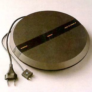

Bang & Olufsen's solution was the Active AM Antenna 10 (type 2037), an accessory that could be used with all Beocenters and Beomasters covering LW and MW bands. The technique which the Active Antenna employed was new and design patents were applied for at the time.
Inside the neat, unobtrusive disc were two ferrite-rod aerials and an amplifier. The two aerials were precision-coupled to 'flatten out' the signal amplitude across the entire frequency range and eliminate the need for the variable components which, in conventional designs, have to be adjusted manually when changing from one station to another.
The directivity of the Active Antenna was superb. It was found invaluable of areas of difficult reception where it could be rotated to minimise noise sources of unwanted stations, ensuring clean, clear reception from previously 'mushy' transmitters. Its sensitivity was comparable to a good rooftop aerial, yet it took up little space, needing no permanent fixing and could be independently sited on any shelf or, if reception conditions permitted, hung on the wall.
The Bang & Olufsen Active Antenna 10 was connected to the AM socket of a Beomaster or Beocenter and to the mains. Power consumption was only 2 watts, so the antenna could be safely left permanently switched on. It required no day-to-day operation or maintenance.
