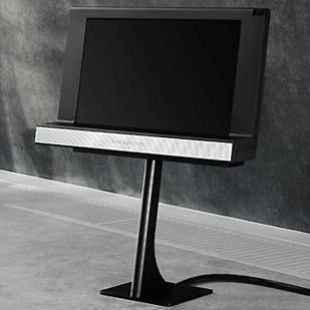

B&O's long awaited answer to replacing the long running Beovision MX range of stand alone televisions which dated back to 1985, the Beovision 8 was released first as a 26" model and was followed by the 32" model later in the same year.
Sharply styled
The set was a marked change in direction in styling with the trademark contrast screen no longer fitted. Instead a radical new look with a prominent speaker box was seen and the same Sharp LCD screen as seen in the Beocenter 6 26" was fitted. Resolution was set at 768p - completely acceptable for a screen of this size. Particular care had been taken with the speaker which had been optimised for speech reproduction. It utilised three drive units - a 50mm treble/midrange unit mounted at the two opposite ends and a central 100mm woofer. This was separately enclosed and unlike the midrange/tweeter was in a bass reflex box to enhance the output. In some ways this set up resembled that of the Beosound 1 thought that unit had separate midrange and tweeters rather than relying on a full range unit.
Connected to the future
Unlike the other LCD sets in the B&O range, an HDMI socket was fitted which allowed the connection of a digital source. The set also came as standard with two SCART sockets though one extra cost option was the so called System Module which provided a Masterlink socket, an RF modulator and a third SCART socket.
Dark smoothie
Soft touch plastics predominated with an aluminium grille for the speaker with the brand name prominently displayed. Only black with a silver grille was available at the launch.
A range of stands were provided with options for storage of other source boxes or a minimalist black metal single leg.
Digitally challenged
However what attracted a fair bit of attention was not only the daring styling but also some omissions to the specification. With some countries actually starting to turn off the analogue transmitters, the absence of a DVB-T module for the Beovision 8 was a surprise. B&O's argument that this was a set designed for use in a kitchen or small bedroom and would be likely to be attached to the main room digital tuner was reasonable if possibly a little mean. Full STB-C connections were fitted and, to be fair, offered considerable scope for upgrading, something that would be far more expensive should an internal tuner have been fitted.
Not easily surrounded
Of rather more concern to some was the absence of a surround sound option. A single Powerlink socket was fitted to allow the use of stereo Beolab speakers with the option of Centre Balance control, a feature seen on Beovision sets in the early nineties. However there was no Dolby or DTS surround, implying that this set was not designed to be part of a main room set up.
Remotely attractive?
And there was one more surprise! In the UK the set was supplied with no remote control - although it was not able to be operated without one. The rationale behind this was two fold. Firstly, much like the Beovision 3 28",which was another of the models it replaced, the Beovision 8 offered a very low headline price to attract customers more used to buying other brands into the showroom. And secondly, the customer was then offered the choice between the Beo4 remote and the brand new and much more expensive Beo5.
Mounting Options & Stands
This model was supplied with adjustable tilt feet designed to allow the screen angle to decline when placed on furniture. The original Bang & Olufsen Floor Stand did not allow rotation or screen adjustment and was soon replaced by a three position, open front cabinet, supplied with wheels. The wall bracket allowed limited rotation to the left or right and screen tilt adjustment.
