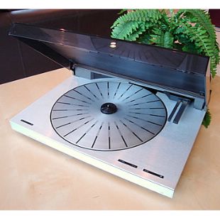

If your system dates from before the Beocenter 9500, it is likely it has a special input designed to take a record player. If so, the world of Beograms is open to you! All of the Beomasters utilising datalink will work with all the decks except:
These Beomasters require a deck with a built in pre-amplifier known as a RIAA. The decks so fitted are not suitable for the other Beomasters. They are:
These decks have the additional advantage of being able to work with the Beocenters made after the Beocenter 9500 and Beosound music players. For instance:
The Beocenter 2 will also require one of these decks but does not have a DIN socket for an AUX input.
There are a couple of oddities in the range. The Beogram 6000 quad is fitted with a CD4 demodulator which produces 4 output channels at line level and can be used as a stereo deck with the above systems as well - and very stylish it is too!
